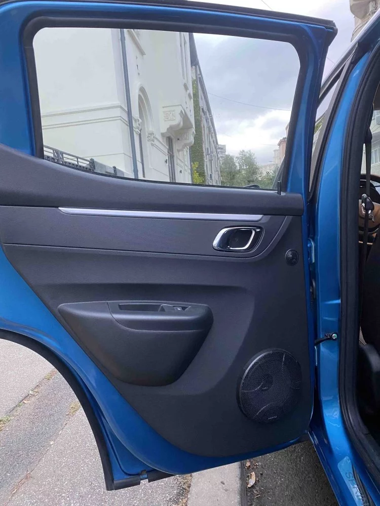

The single possibility to activate rear speakers channels is to rewrite the audio parameters with DDT4all. There is a set of audio parameters which activate rear speakers channels.
I already made this and installed 16cm Herts speakers, + tweeters, in the rear doors. Sound is much better.
Activating the rear channels with Micon is necessary as the first step but it dose not make them real active.

Micon activation just make the balance thread on the front/rear to be possible. It is necessary as first step. After this you need to rewrite the audio parameters with DDT4all. There is a set of audio parameters for Medianav with 4 channels.
I already made this and I installed Hertz 16cm speakers and tweeters in the rear doors. The sound is much better.

Hm, do you think this is a good place for sound? Isn`t it better on the backplate for the frequences....Yes there is only little place in this car, but I think there the sound will run into the universe of the backfootroom. May be I have to listen to your car to hear the opposit...My theory says no.
