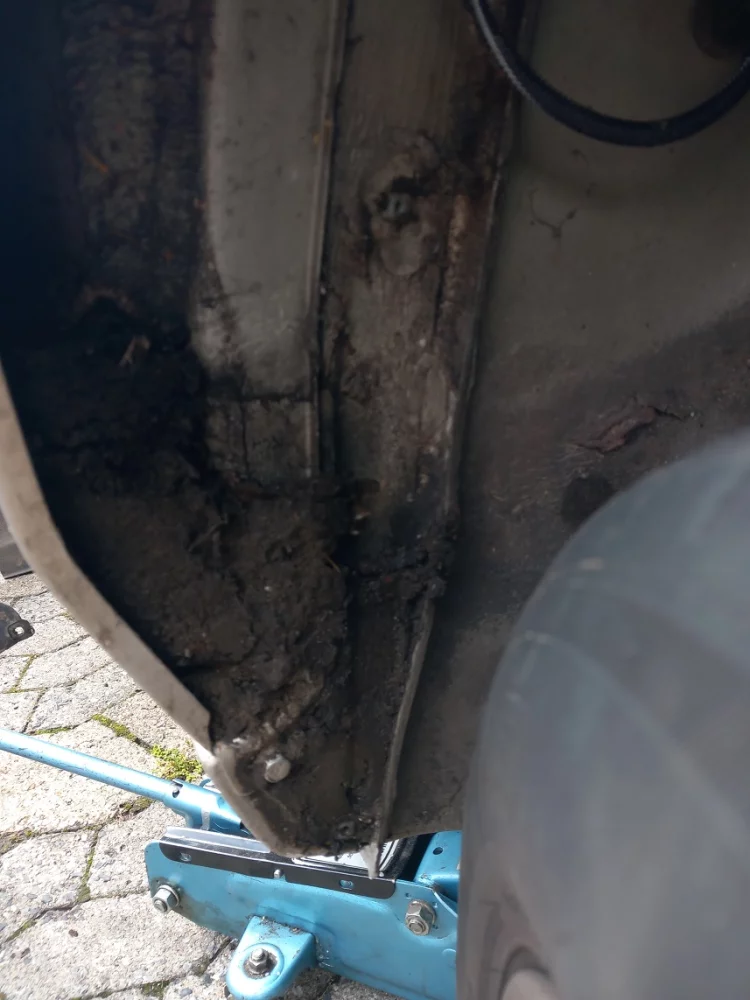

![20250730_155719[1].webp 20250730_155719[1].webp](https://www.springforum.de/data/attachments/17/17670-e9681a4a61e876e99c56b40e9fcaf412.jpg?hash=CyuVlyYDsR)

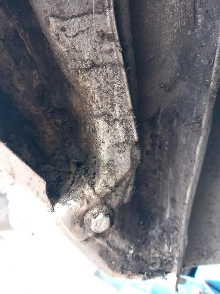

![20250730_160237[1].webp 20250730_160237[1].webp](https://www.springforum.de/data/attachments/17/17672-bc386c22d8cac9e40beaf7b1f0e519c3.jpg?hash=8CJJvVE5W1)
