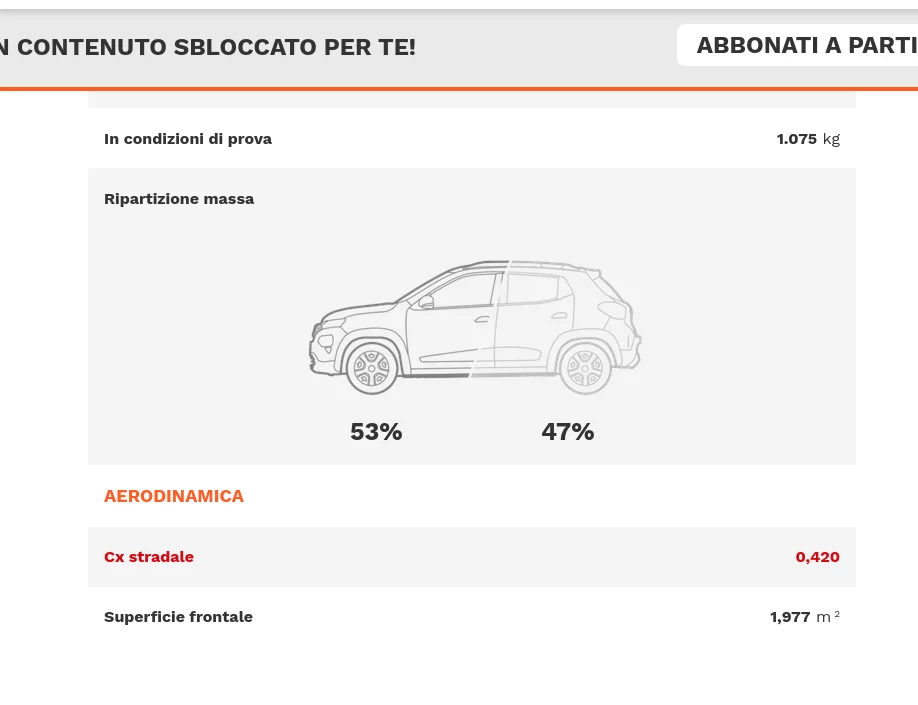

Is there anybody that tried to improve aerodynamics (mainly to reduce dragging) on his Dacia Spring?
The car seems to have a really too bad CX, that of course impact who use the car especially on motorway.
Consider that our Spring has a CX of 0.42, while tesla model 3 has half the CX (0.21).

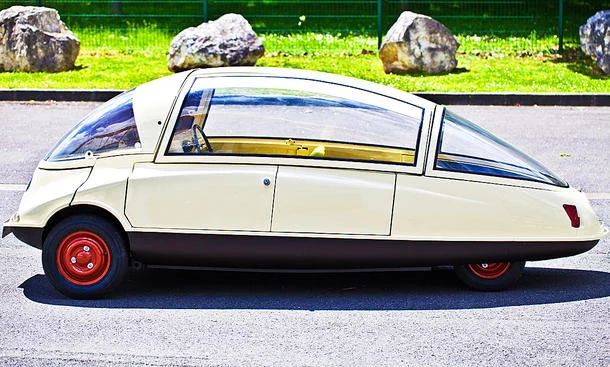

Here would be a 0.23(!) result:
Citroen C10 in Tropfenform/ Teardrop shape inspired by Aircraft construction🤤

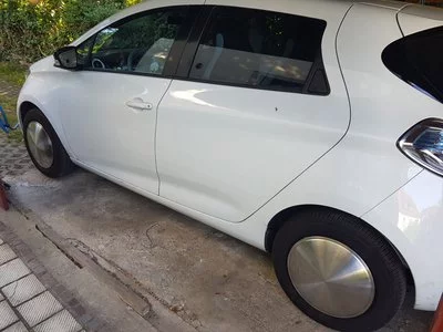

I've already seen this on a blue Spring🤔158€💸The cardboard version from the videos is of course much cheaper😃Just as ugly but cheaper🏎️I would have removed the roof rails a long time ago if my wife and brother-in-law hadn't objected..🤷‍♂️And so I dream of making my Flyke aircraft more efficient. Nobody can talk me into it. The use of acrylic sheets was also very interesting for me. Thank you for that🤝

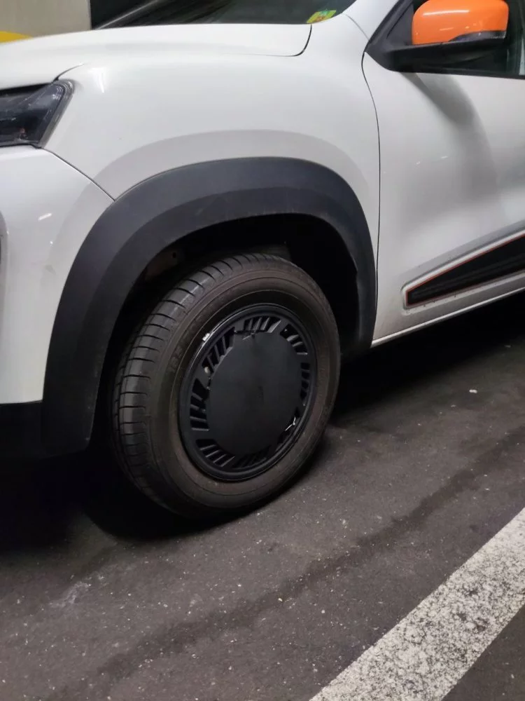

I started from the cheap & simple things: the rims.

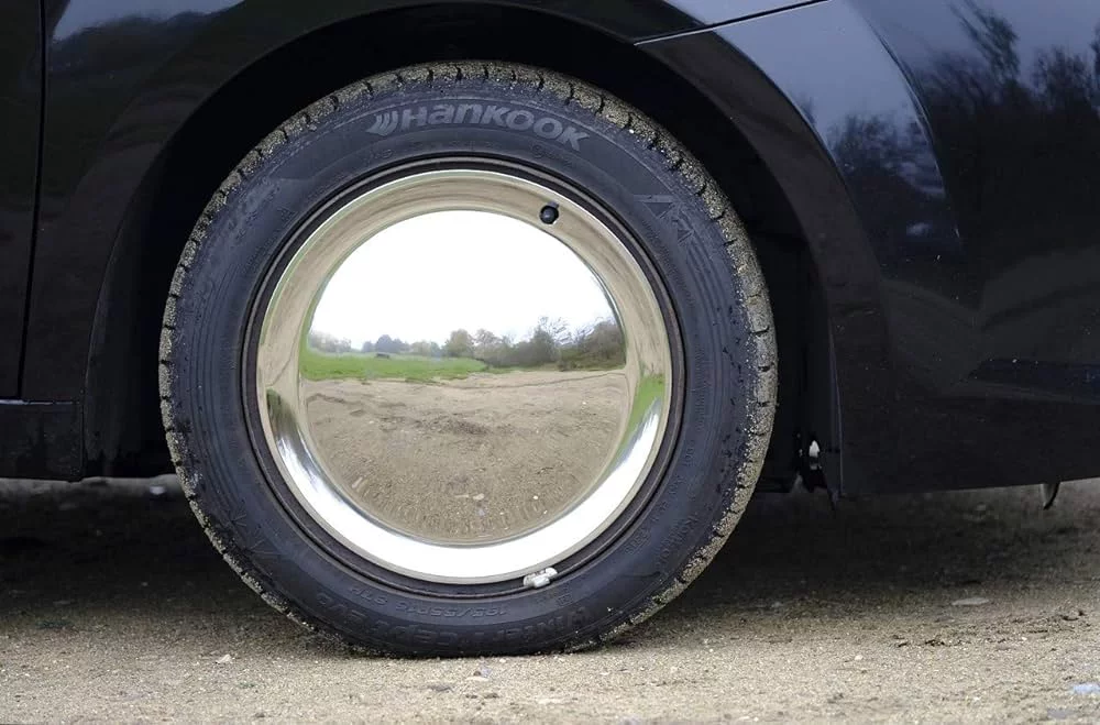

Reading online, a lot of forums recommend the "moon caps", like these
but... they are kinda expensive, and the expected improvement is not so high.
So, i though... what about something cheap, like
so... with 20 bucks I found a good solution.
And, with a paint-spray can, they became better
Cheap and fast.
As of now, I just installed the 2 on the front wheels, and on the back I don't have any cover.
I did just one trip, so it's too early to say this thing is effective or not.
I will paint in the weekend also the 2 remaining caps and will continue tracking data. It's really hard to track this things properly, due to the wind, the temperature and the weather in general.

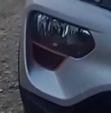

After that, I was thinking about covering the front left and right grill
with a transparent plexiglass panel to have the surface as plane as possible.
I just need to find how to anchor that in a safe way to the car body.
It seems to me that this part of the car is producing the same effect of a spoon, stopping air instead of letting that flow.
Am I wrong?

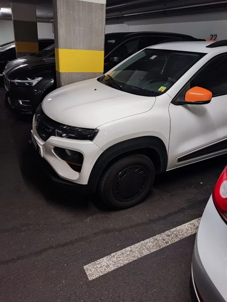

Ok, some considerations:
- Rim Covers installed since 1 mth - done 3500 km +-
- Adapted (from Clio) engine bay undertray cover - done 1000 km +-
Enhancements:
- with only Rim Covers, I saw a consistent 5-7% saving, than original rims without original caps
- Undertray cover= Need more trips and time, but as of now I would say a consistent 5% of improvement
with my actual setup, with stock rims & tires, custom rim caps, undertray engine cover, I reached the goal of being able to commute without stopping during the trip at the fastest speed legally allowed :) so, at least for the hot season, goal achieved.

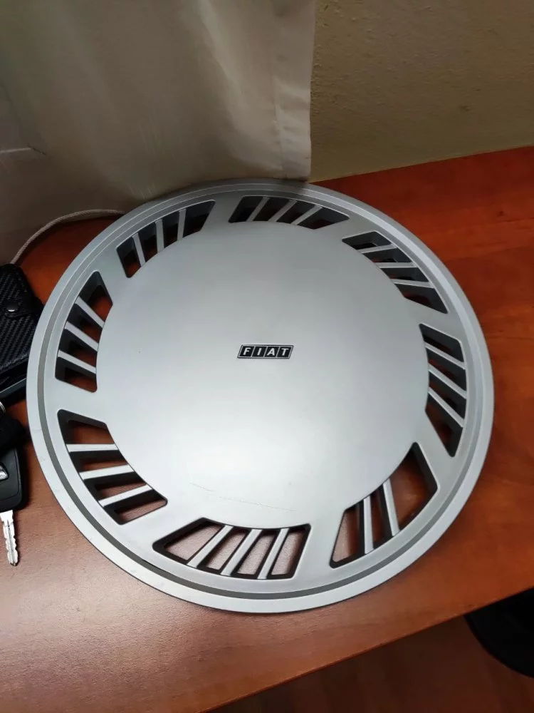

Sorry da kann man noch so drann feilen. Der Spring ist kein wirkliches Langstrecken Fahrzeug.
Eher ein Fahrzeug mit dem auch mal eine lange Strecke fahren kann.
Notfalls...
Die glatten Deckel, sind doch nicht wirklich schön. Fiat nee.
Wobei ja Schönheit im Auge des Betrachters liegt.

- For the caps: It's not so easy to see the fiat badge, but still it is removable (I am lazy) just popping out the badge. Consider that these rim covers costs like... 20 euro in total? Way cheaper than the moon caps :)
