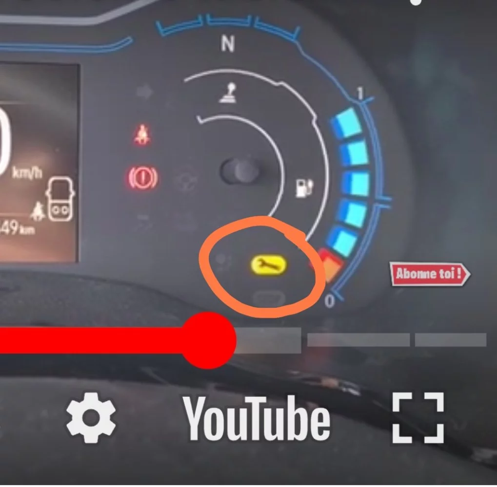

Yesterday my daughter had the same problem with her jumping. Found this link (in French from minute 7:50)
This explains that the problem can be solved. Remove the screen fuse and reinsert it. This fixed the screen problem, but I now have a small yellow button on the display and a message about an error.
I forgot to mention that it was not possible to charge the spring when the screen was switched off. The message "Wait for authorization of the charging process“ was displayed on the charger.
Another question: Is it possible to reset the "yellow warning key and the error message“ on the display via an ODB2 dongle, or do I have to go to a Dacia workshop?
Which yellow warning key do you mean? There is a plenty o yellow lights. If there is something written you can try to go with the knob of km reset to the text and then pressing it long. If thats not possible---got to the garage.

Man müsste schon ein komplettes Foto vom Tacho haben, da sind oft noch andere Abschnitte beleuchtet.
Sicherung vom Display ist Quatsch, da der Fehler meist von einem Steuergerät kommt, da kann das Display nichts dafür. Einfach mal für 1 Stunde die 12V Batterie abklemmen, und schauen wie es danach aussieht. Pyren für den Spring kann man immer noch von meiner Webseite herunterladen :
