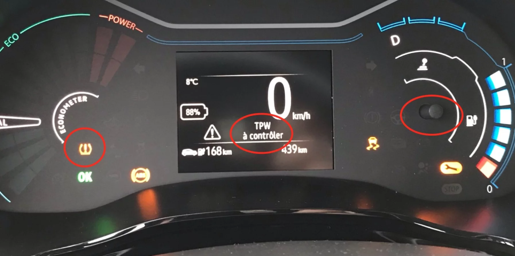

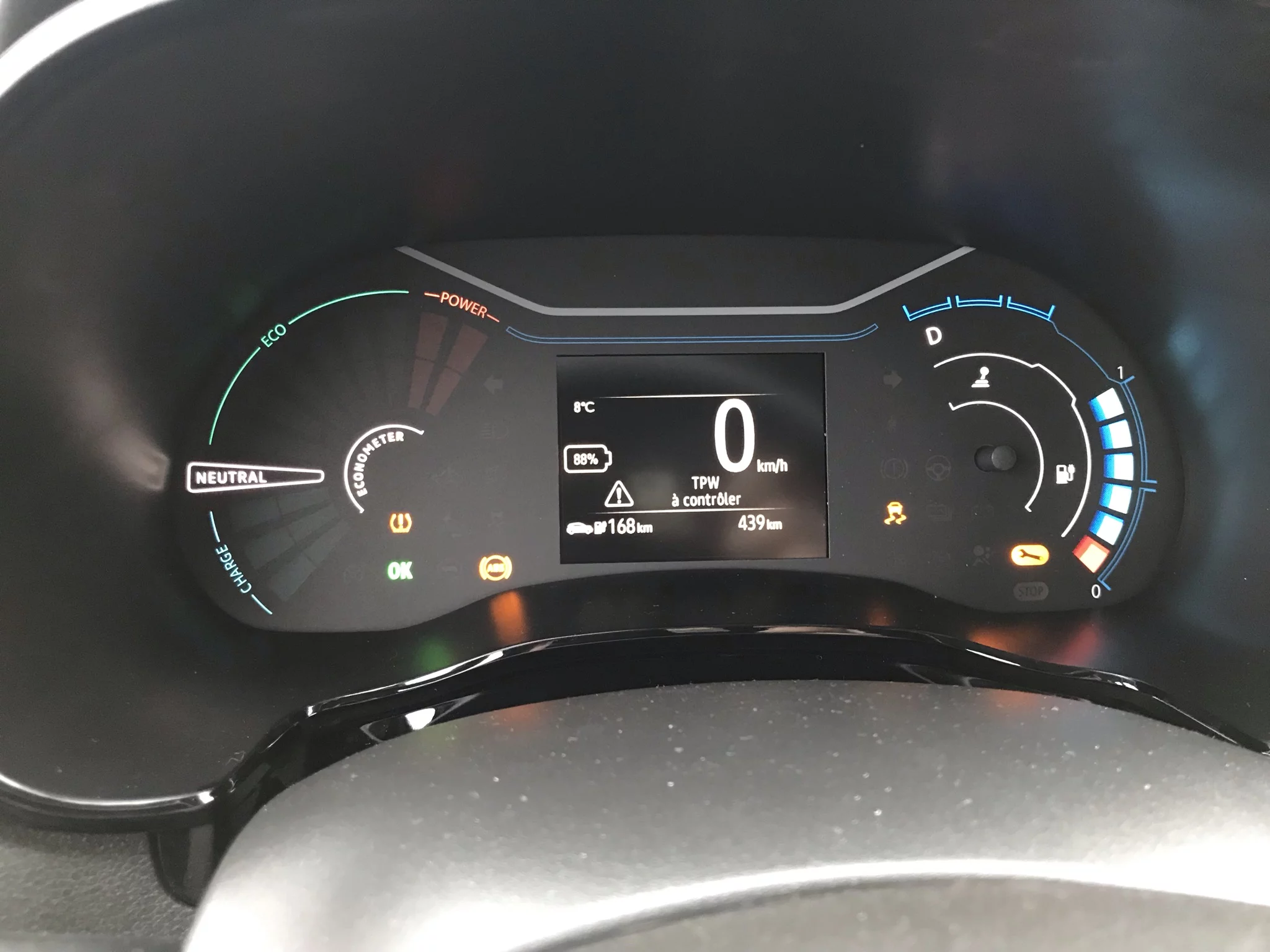

hello, i write in english because my german is not that good. We have now driven our Spring for about 2 weeks, 500 km and so far very satisfied. But yesterday while driving several warning lights came on simultaneously. See picture. However, the car still drove perfectly. We drove on and went shopping. After 15 minutes started again and all lights were off. Tire pressure checked at home and in order.

Looks like the check after putting in the key... maybe the Key-lock has a loose contact
mcvcfix
OMG It clearly indicates visit workshop so better just do that 8 )
looks like ESP/ABS maybe wheelsensor related. If you had an OB2-Dongle and an the APP Torque you could tell yourself...
Have the tyres/wheels been changed ? Maybe they unintendidly messed with the sensors ?
Better visit the workshop, should be on warranty anyhow.
Der Paul
TPW = Tire pressure warning
pls start a new TPMS (Reset)
Tire cold!
Pressure are correct!
  • press the right button an see "TPMS (Reset)"
  • press the button longer as 3 sec and start the initialization
  • „SEt tP“ is now flashing 5 sec an than permanent
the tire pressure is now saved
Wim
I also suspect that it was a TPMS sensor that went wrong for a while. I don't know why the ABS and ASR also give an error message. If it happens again, I immediately drive to the garage so they can read it. I'll keep you informed.
mcvcfix
The Dacia Spring has a low cost TPM without any actual pressure sensors but relies on an initialization state that is assumed to be ok (2,2 bar etc).
It than counts the wheels resolver impulses and counted on a straight lane they should stay steady. If a tire looses pressure the circumference decreases, the wheel speeds up to keep pace with the other wheels so the system notices that there is something wrong on that wheel. The same impulses are used for ABS and ESP in conjunjtion with steering wheel angle, lateral speed and angular velocity
