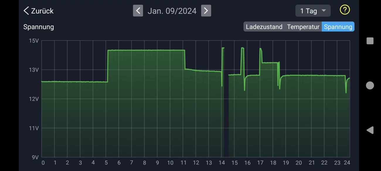

The reason could be an aged 12V battery like mine. In these cold days I have also sometimes losses of SOC about 2%.
Due to the fact that I monitor the 12V battery with a Bluetooth device all time since one year, these losses could be charging over night:
The battery voltage is checked almost every 8h after the last use of the vehicle. If voltage is under 12,58V, charging begins with almost 14,4 V for exactly 6h. This could cause a loss of SOC about 2% over night.

mmm interesting, but it is really "common" that the 12v battery stays below 12.58v... does the 14,4 v charge starts at any "main" battery level? what if I leave the car at 25% in the garage for 20 days? could I expect the need of a tow truck to go out from the garage because of that? (unfortunately... I cannot charge the car in my garage...)
I can only report my experiences.
Well, I do not know, but I expect that.
Leaving the car in the garage for 20 days with a SOC of 25% shouldn't be a problem except outside temperatur is about -15°C and 12V battery ist old or weak.
