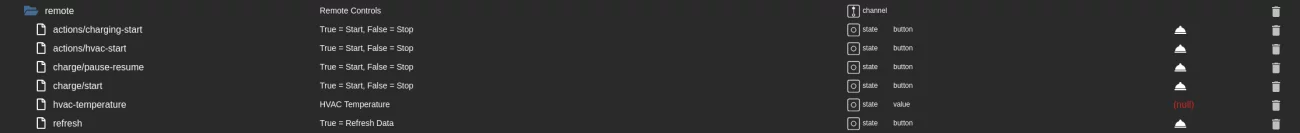

these are the functions already implemented:

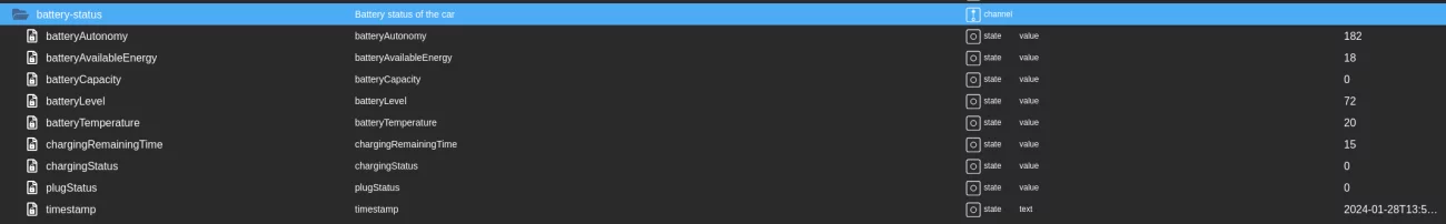

these are some stats you can grab from the battery:
There are some ways we could take to automate the charging stop, but unfortunately the info are not really precise. Let's say eg I would like to stop charging the car after 10 kwh. In that case, the idea could be "switch off" using one of the remote functions when BatteryAvailableEnergy equals 10 + x , considering x the value of the battery when we started charging the car... but this thing is really not so precise
